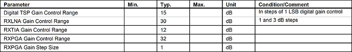

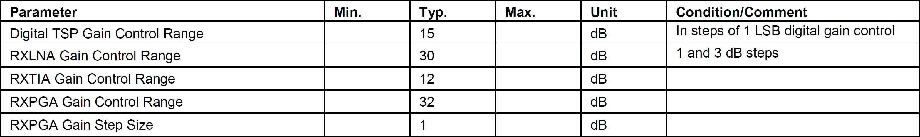

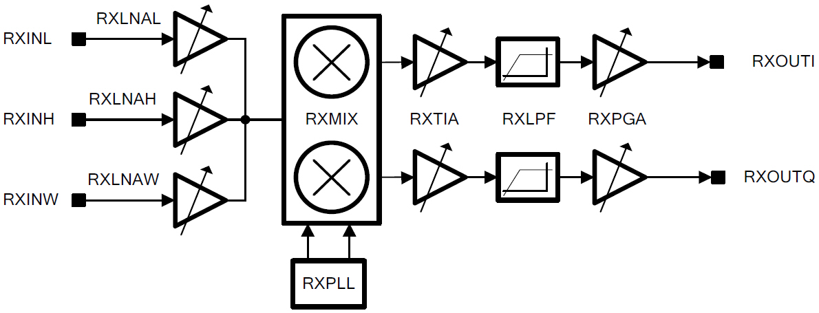

Lime SDR has a 3 stage amplifiers
with these ranges
Does SoapySDR Source controls automatically the three amplifier’s in a transparent mode for the user?
