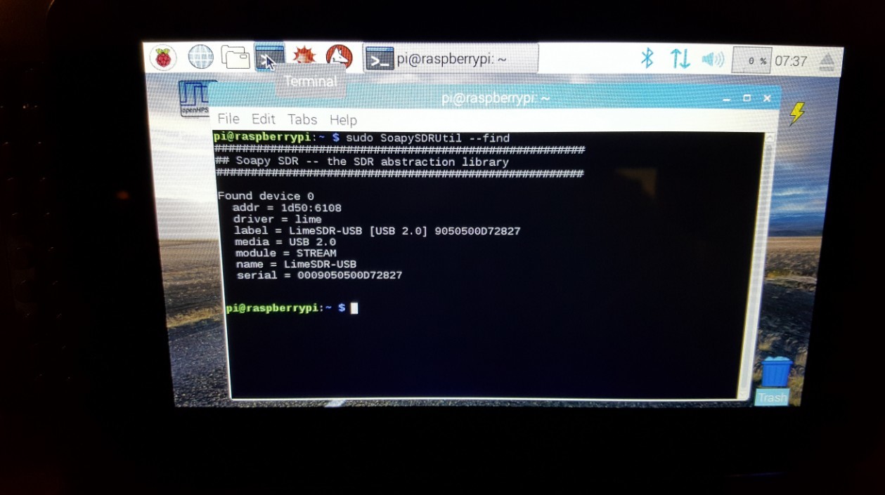

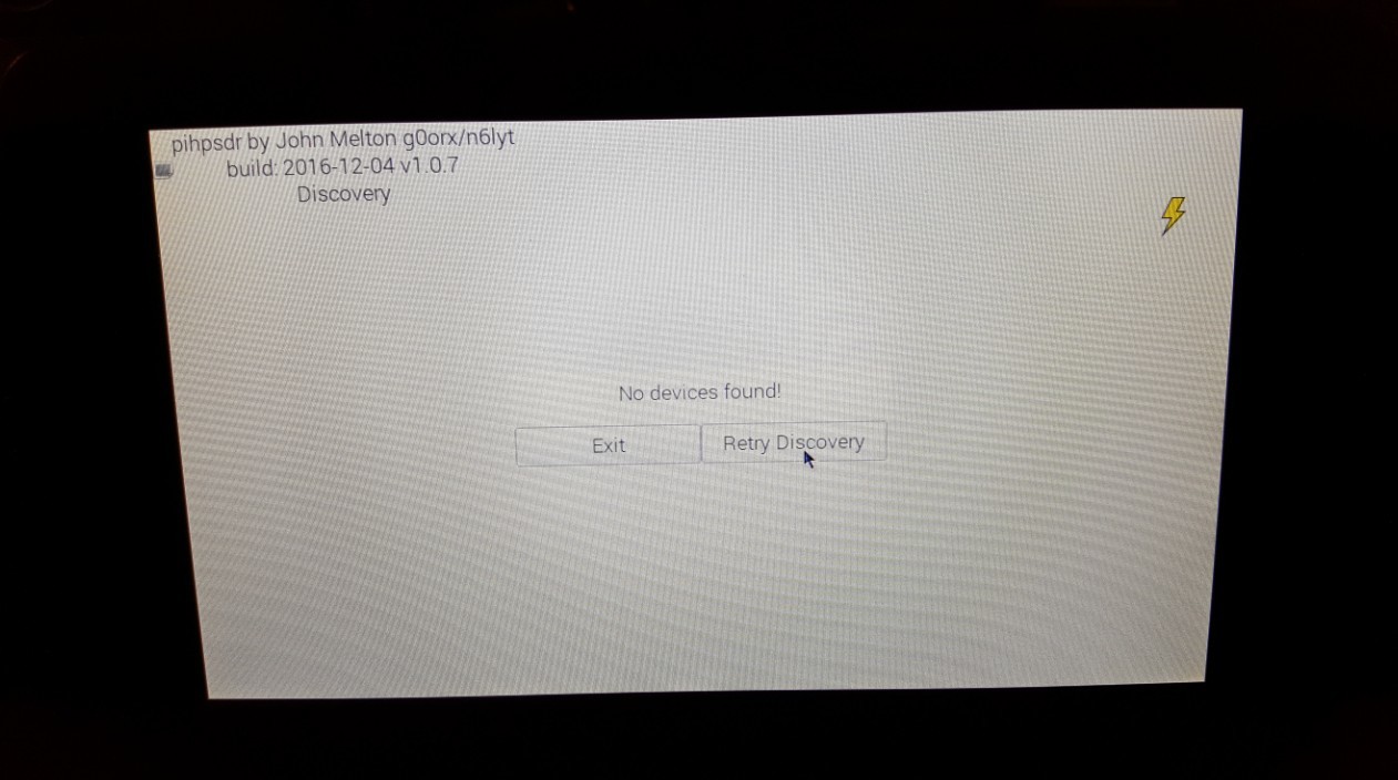

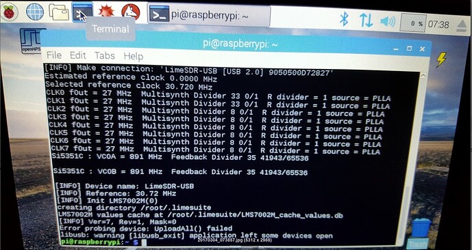

So as I am so apt to say ‘Taking matter into my own hands…’ I finally installed SoapySDR (again) and LimeSuite (the pieces you need for PiHPSDR to compile right) and here are the results:
Soapy works because I can interrogate it by itself and it’s seeing the Lime doing a ‘Find’ and ‘Probe’ (see pics), but it’s just not seeing it in the PiHPSDR app when it hunts for the attached devices (see the PiHPSDR screen and the setup). I JUST had the Lime plugged in since I didn’t want it to hunt for my Red Pitaya - so the Lime was the only active device on USB 2.0 (Pi3 has no USB 3.0 resources - but Soapy still finds it as a USB 2.0 device).
Did a clean compile of PiHPSDR, too, and it compiles fine with all the resources there and installed in their proper locations (nothing custom here, okay?). So I’m not sure why PiHPSDR isn’t seeing the Lime - the Make file has been de-commented for the LimeSDR so it will compile. Compiler didn’t whine once about anything - compiled perfect. So I’m not sure how mature PiHPSDR is unless anyone else has it working on their setup (I know John’s working on it and since last July has the Lime receiving on one antenna port on PiHPSDR).
