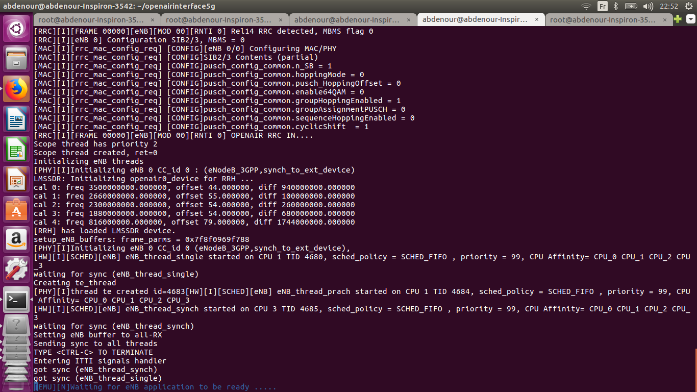

I’ve followed step by step the tutorial of Bastien on OpenAirInterface 4G/LTE with LimeSDR_Mini – Linux hacking . But I got always those output :
When i stopped the program lte-softmodem, i have this prompt :
OS : Ubuntu 16.04.4
LimeSDR mini rev 1.1
LimeSuite version : v18.10.0-g3cbdb8bb
SoapySDR version : v0.7.0-g6d21756e

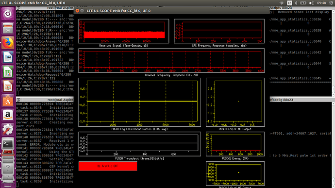

Thanks for the reply @dast , I have solved the problem after I discovered a little mistake in my MME config file. I think now it runs correctly :
But after some moments I got this debug message after the “L” : " [PHY][I]rx_rf: rfdevice timing drift of 2720 samples (ts_off 26720)"
Xforms scope :
You can find my ltesoftmodem log file in this link :
