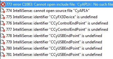

When I set this up in my Visual Studio 2013 environment using the CMake app, I get an error about CyAPI…
…and about 772 warnings, too…
…I know that I’ll have to add the Cypress USB drivers to this somehow (if you can tell where to put those where the compiler won’t whine at me that would be great), but does this happen on a fresh install based on the instructions in the compiling guide?

if you followed compilation instructions, I assume you have Cypress SDK installed somewhere.
So lets check if the CMake is able to find Cypress include paths. They should be displayed in CMake GUI like this:
If those entries are not filled/incorrect, fill in the correct paths of files and click ‘configure’ and ‘generate’.
Ignas,
I redirected the CyAPI.h and .lib file to the appropriate spot where the SDK is installed (same location as you have) and it compiles fine now albeit with some warnings. I see the console apps in the build subdirectory and will check those out later this evening.
