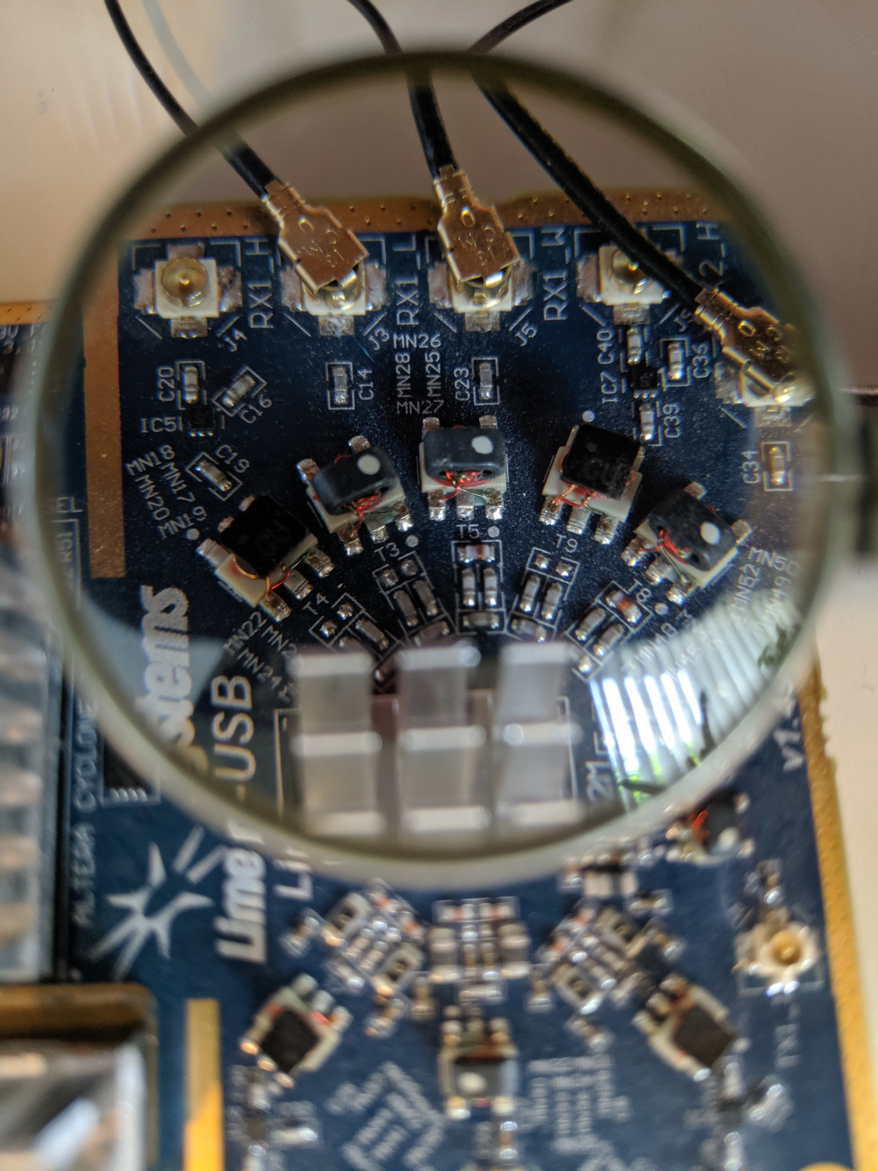

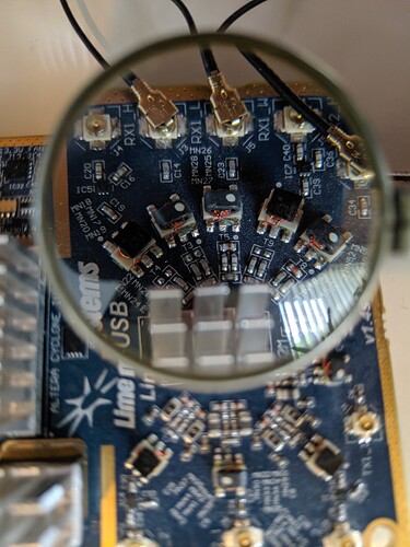

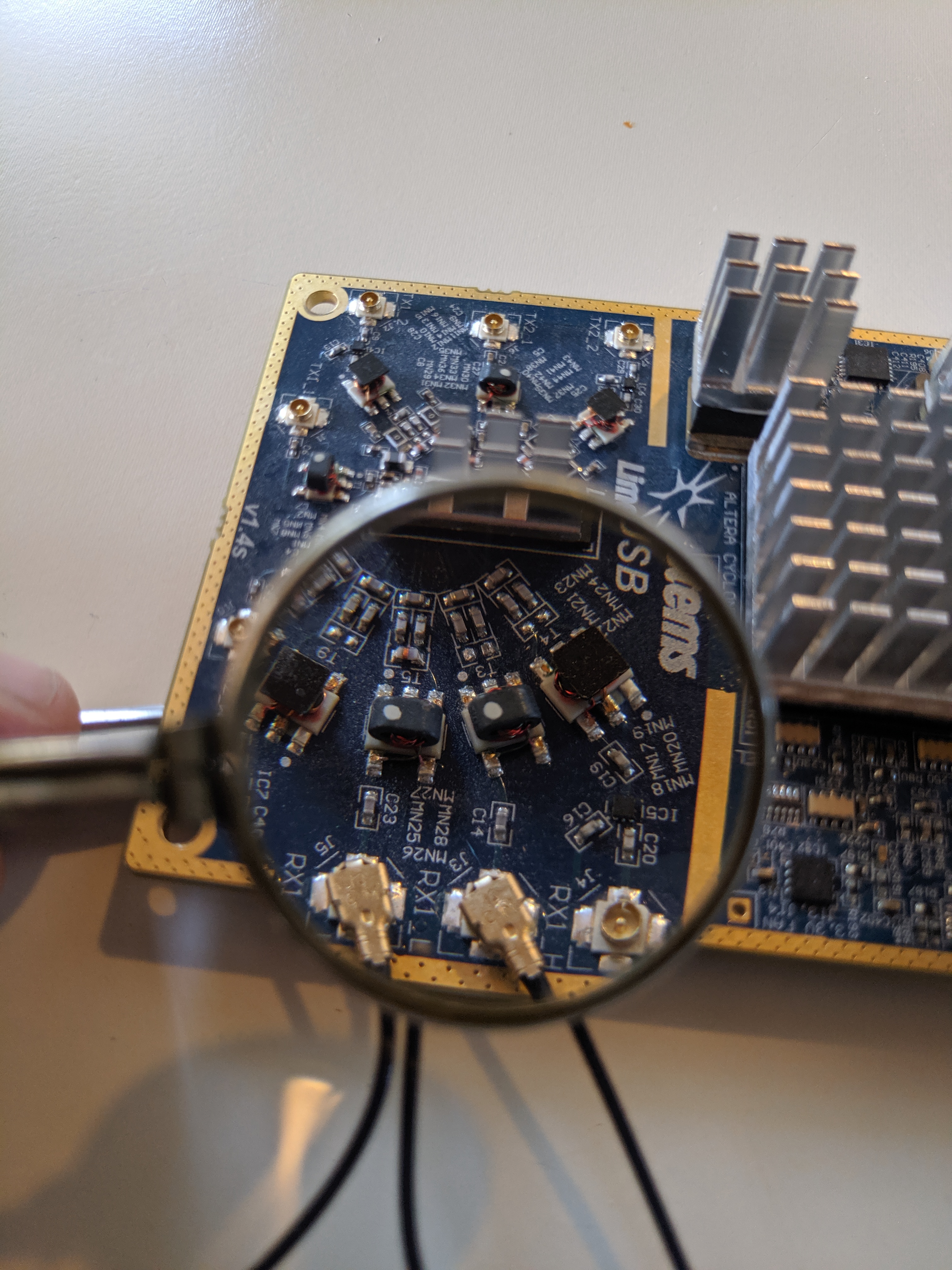

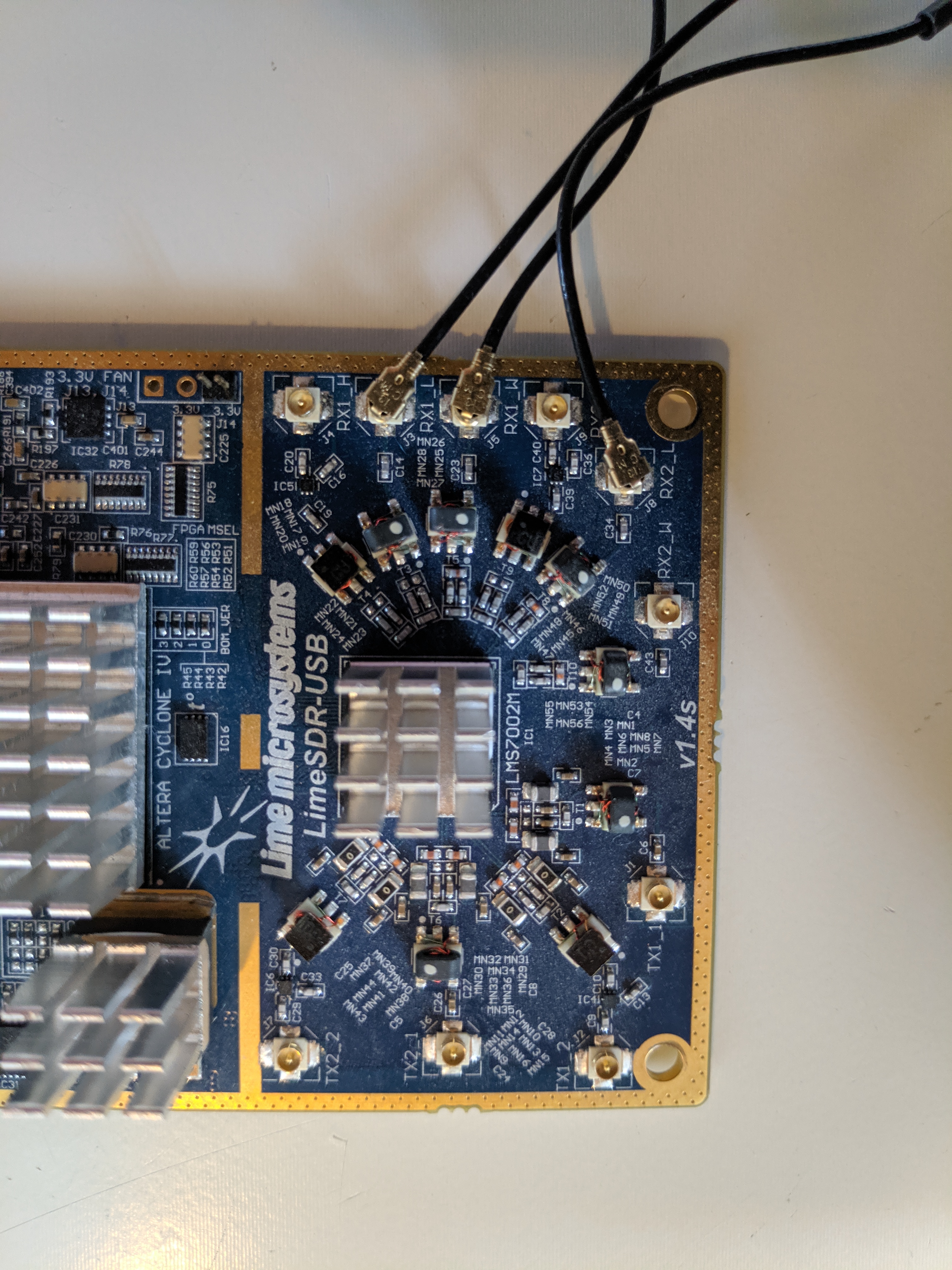

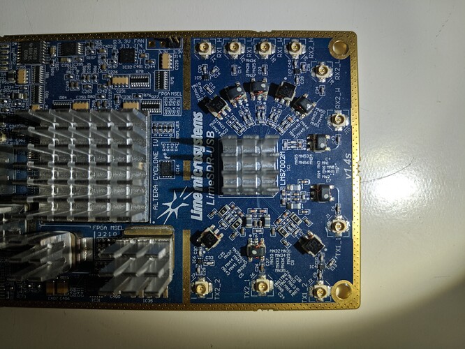

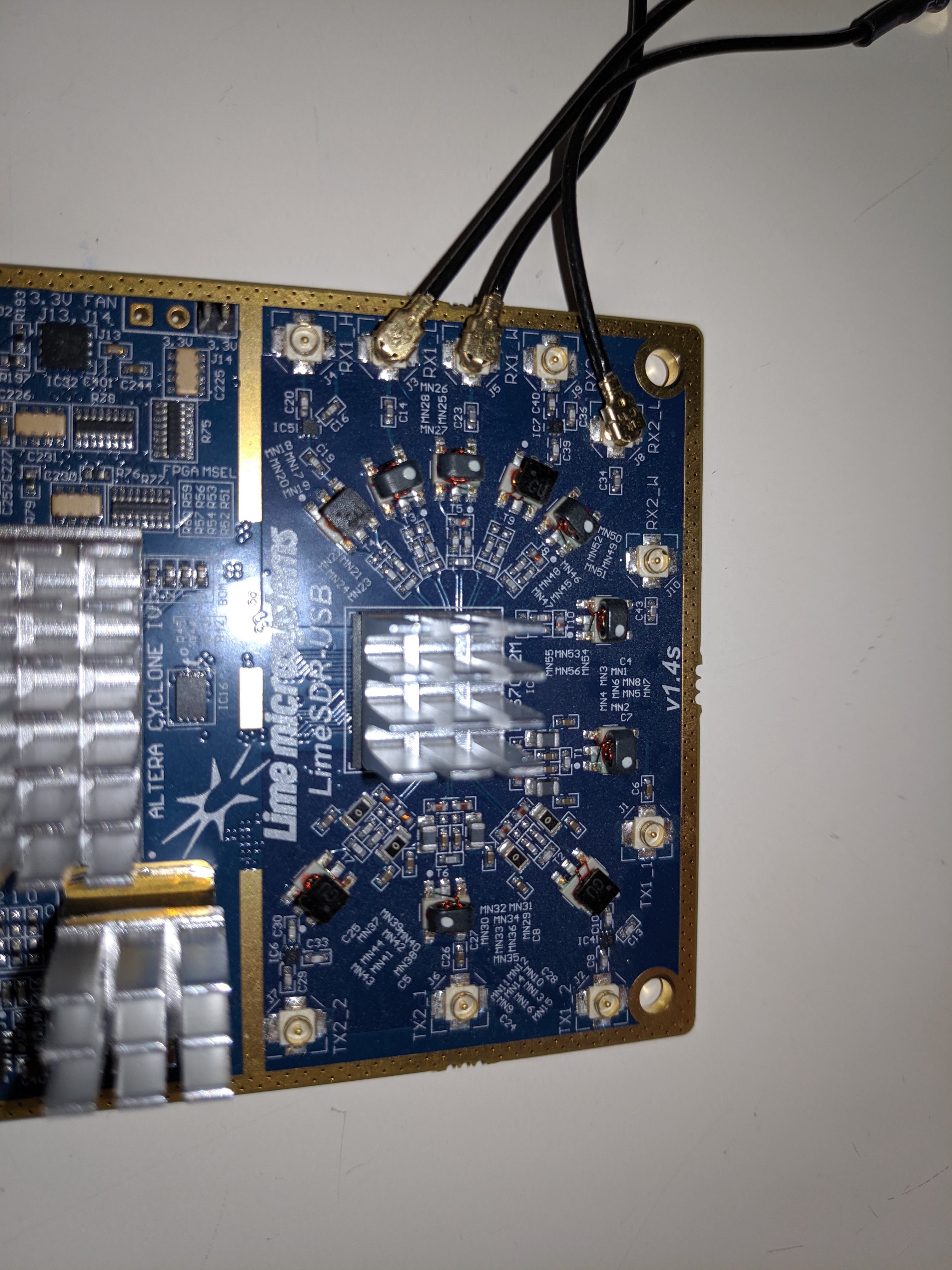

Could you please share you LimeSDR-USB photo, I am interesting in RF part.
There is a bit of dust, but that’s because it has been well ventilated since I got it in late March.
that’s the time I’v used to finally learn that Rx1_l was my problem, but I’v learned a lot at my way. Same as all other open source stuff I’v played around with. And that’s nice.
Don’t know how to test the small transfo for Rx1_l but I think the problem is there, but as I can see all cords is in place, but total deaf. ![]()
