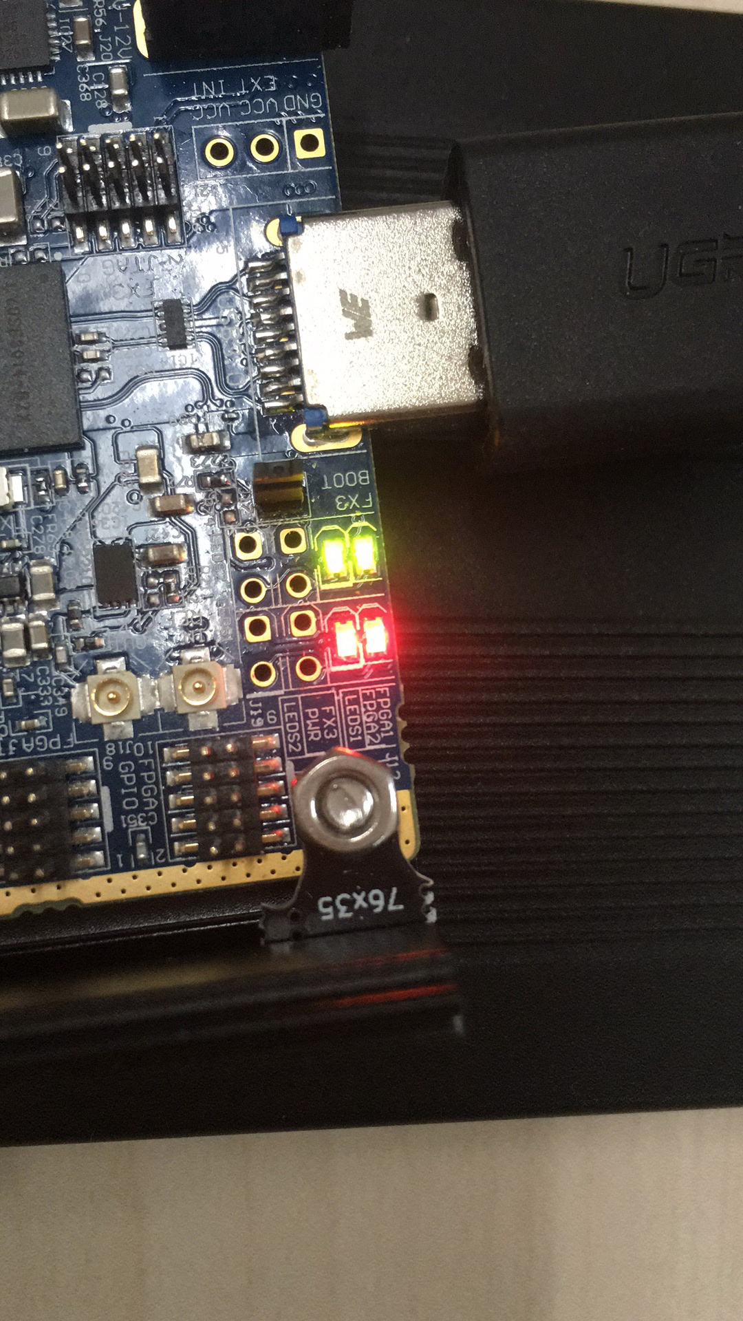

The lights are green for usb and red for fpga.
