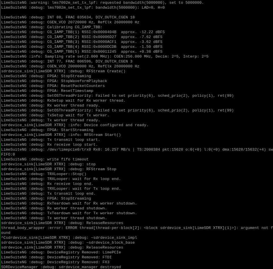

When receiving in MIMO, this solution works fine. However, when transmitting on one port with a Signal Source at 250kHz, a sample rate of 2 MHz, and having a Null source linked to the other, I now face the following errors shown in my terminal:
One interesting point I noticed is that it transmits for one frame (as the terminal only displays a trx0 debug message once as you can see), and I indeed receive the signal for a split second before it disappears when the following error displays:
thread_body_wrapper :error: ERROR thread[thread-per-block[2]: <block sdrdevice_sinkLimeSDR XTRX>]: argument not found
I thus only receive the DC signal that is by default and lose my transmitted signal source. Even when I put 2 signal sources on each port, the same error pops up. Do you know why this is and how to fix it this error please?
Thank you,
Timothee Mac Garry
should be fixed in gr-limesuiteng: Set Sink to work with 256 sample chunks. · myriadrf/LimeSuiteNG@ef75a77 · GitHub

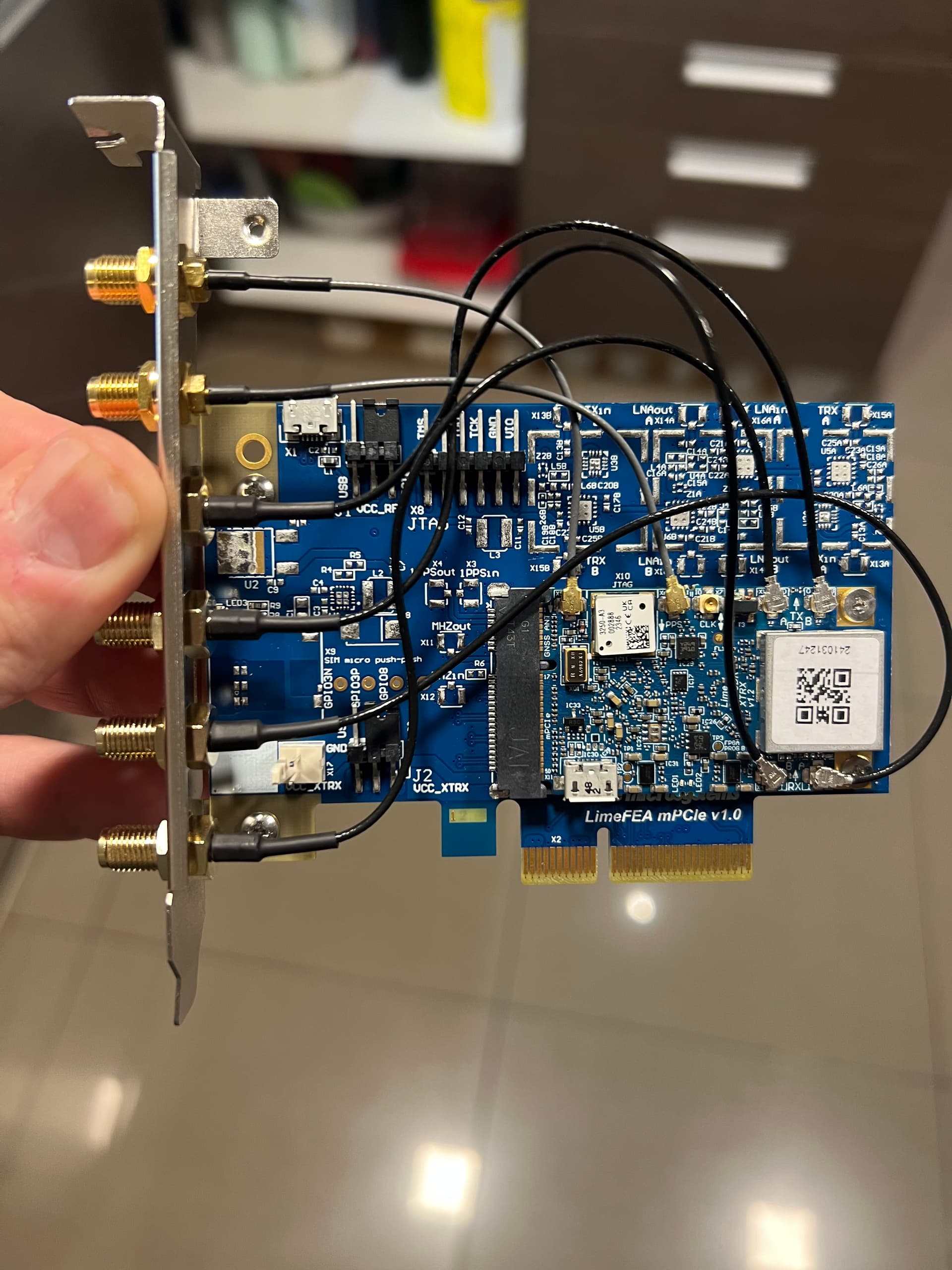

I’m a noob in this field. I have a LimeSDR XTRX and I’m trying to transmit noise and capture it in the spectrum analyzer. I’m using Ubuntu 22, LimeSuiteNG, and GNU Radio. Everything is working, but I don’t know how to use both TX ports.
I tried using the GNU Radio LimeSuiteNG Sink Block by changing the “Data Channel Indexes” to [0,1], but I got an error. Using [0], I can successfully transmit using physical port A (TX_A), but if I try to use port B (TX_B) by changing the “Data Channel Indexes” option to [1], nothing happens.
Is the antenna port parameter useful?

When you set [0,1], the Sink block has two inputs, both of them have to be connected in the graph.
It controls which of the antennas should be used. You can just leave it empty or set it to ‘auto’, then antenna will be chosen based on your LO frequency.
Currently there is a bug, when attempting to use only the B channel. If you want to use only B channel, set the channel indexes to [0,1], and simply connect Null Source block to the A channel.
Thanks!!! Works perfect now !!!
