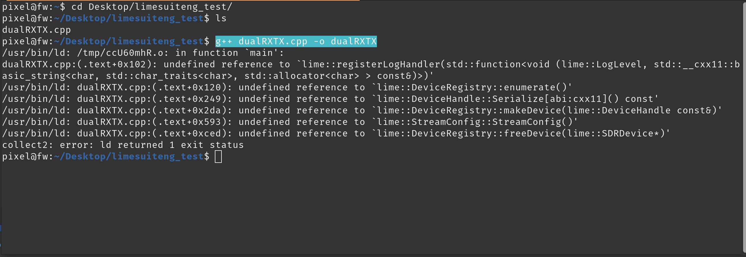

Here’s dualRXTX.cpp unmodified inside limesuiteng_test directory when I run g++ dualRXTX.cpp -o dualRXTX in the terminal:
C++ builds are done in two steps. Compilation and linking.
Your command does only the compilation step, so after it’s done it cannot find those functions, because they are located in external library. You need to explicitly specify to your compiler where to find those functions/which libraries should be linked to your application.
In this case you need to add -llimesuiteng to your command.
