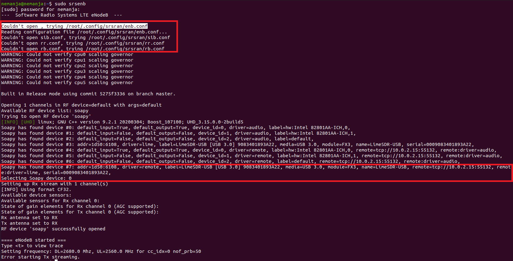

I have found it difficult to run srsenb on Ubuntu 20.04.
I am getting error showed on the image attached.
As shown on image I can see LimeSDR listed but uhd_find_devices returns “No UHD Devices Found”.
That’s because a LimeSDR is not a USRP, hence cannot be used by UHD in this way.
This application note shows how to configure is to use SoapySDR with LimeSDR hardware:
https://docs.srsran.com/en/latest/app_notes/source/pi4/source/index.html
I have two runtime issues when running srsenb:
Srsepc works fine.
Please find attached snapshot.
Any idea how to fix that?

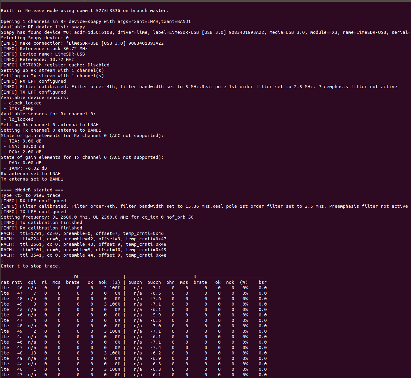

I can see that Rx and Tx antennas are set to LNAL and BAND1, please find snapshot attached.
How LNAL and BAND1 are mapped to the LimeSDR USB antenna connectors?
I have finally menaged to attach with Samsung Galaxy UE to my private network but connection is very unstabile.
In order to configure EPC, ENB to work with LimeSDR I have followed srsRAN Documentation, Release 21.10 (section: 5.2 COTS UE).
Could you tell me how this issue can be fixed?
