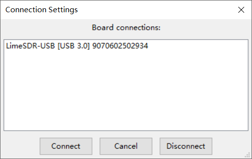

LimeSDR in windows works well as follow

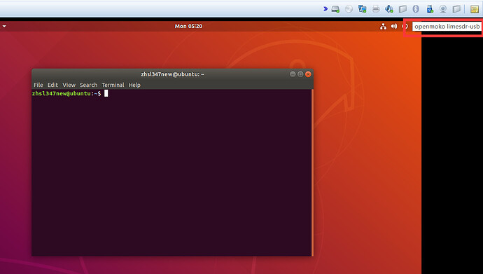

but in vmware player is not recognized use this
How to solve this problem, thanks veryone.

Thanks @keithl, I’m the a),
but the Ubuntu VM doesn’t recognize the LimeSDR device,

Thxs @mzs, the lsusb already identification, but LimeUtil --find has nothing
