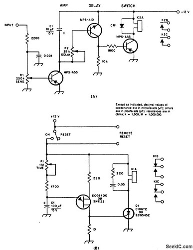

Another way to go about this is to have a COR (Carrier Operated Relay) circuit that is external to the RF path you intend to use and wouldn’t be hard to implement in hardware. The LimeSDR RF output is guaranteed to at least -5dBm to 0dBm (in most cases this would be +10dBm) and adding a COR circuit to the output when activated by the TX button on the SDRConsole GUI would give you the same effect and no software implementation is required. The COR could be as simple as a capacitively coupled FET or bipolar transistor very much like the attached:
This is a fairly common way to switch if you don’t have the luxury to have it added in the GPIO of the 'Mini.
Just my 23 cents on the matter - 73
de Marty, KN0CK
Hi Marty,
thanks for the hints. It is clear to me, to have a control circuit based on
rf-rectification and a specific time constant. Before this, I want to be sure not to
overlook the simple softwarebased solution. I think, there are much more hams
trying to use amplifiers. The goal is Es’Hail transmitting on 2,4 GHz.
I wonder a bit why there is no firmware solution in the FPGA?
At least a rf-vox can do it…of course.
By the way, which current can be used for the fan?
The switch is good for some amps, the limit may be the USB Port ?
Regards
73s
Andreas
I would caution against using a carrier operated relay, as it would be triggered by the LimeSDR calibration routine which generates high outputs on and away from the desired frequency. At the very least you will end up with illegal transmissions, and you may well damage your power amplifier.
Better to challenge the software designers to set a GPIO (on the host computer or the LimeSDR) high when the calibration routine is finished. This is what the Portsdown Digital ATV Transmitter does.
Dave, G8GKQ
