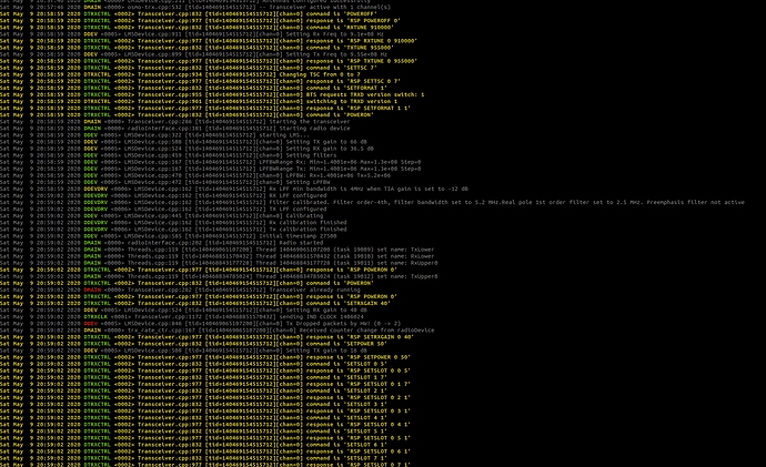

I’m trying to run a GSM BTS using the LimeSDR mini and i can’t get it working with my phones (don’t find the network, (looking for 2G networks))
What I see in the logs:
- There are no errors
- The message “sending IND CLOCK” is repeated infinitely
i try to reduce the power, to put attenuation and it has no effect (according to what i found on forums)

When you start the software in these order, did you have the repeated message “sending IND CLOCK” on “osmo-trx-lms” output ?
sudo osmo-trx-lms
osmo-nitb
osmo-bts-trx -
Is this message a problem on “osmo-bts-trx” output ?
<000b> trx_if.c:185 phy0.0: No satisfactory response from transceiver(CMD POWERON)
<000b> trx_if.c:620 phy0.0: Discarding duplicated RSP from old CMD ‘RSP POWERON 0’
I found somewhere that there was problems one year ago with limesdr that does not respond enough faster so it produce “timeouts” and then the response is not processed. Not sure if it’s this.

When ‘osmo-bts-trx’ is started:
osmo-trx-lms output:
osmo-trx-lms logs:
osmo-nitb logs:
osmo-bts-trx logs:
