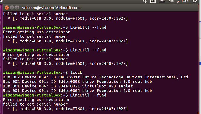

I’m running into another issue with VirtualBox. Every time I plug in the LimeSDR Mini, the vm momentarily recognizes it and identifies the serial number, allowing me to perform the quicktest function or an update, but less than a minute afterwards, it loses it.
The image below shows that the device is still there using lsusb and limeutil --find, but for some reason the serial number can not be found after that short minute.

I did get much better results with Oracle VirtualBox after I installed the additional non opensource proprietary BLOB “VM VirtualBox Extension Pack” that fixes many problems with the virtual USB 2.0 and USB 3.0 bus.
We’ve had success using LimeSDR Mini with VirtualBox once the Extension Pack is installed and device filter is configured for pass through, but I suspect it’s always going to be less reliable than using devices with the host O/S.
