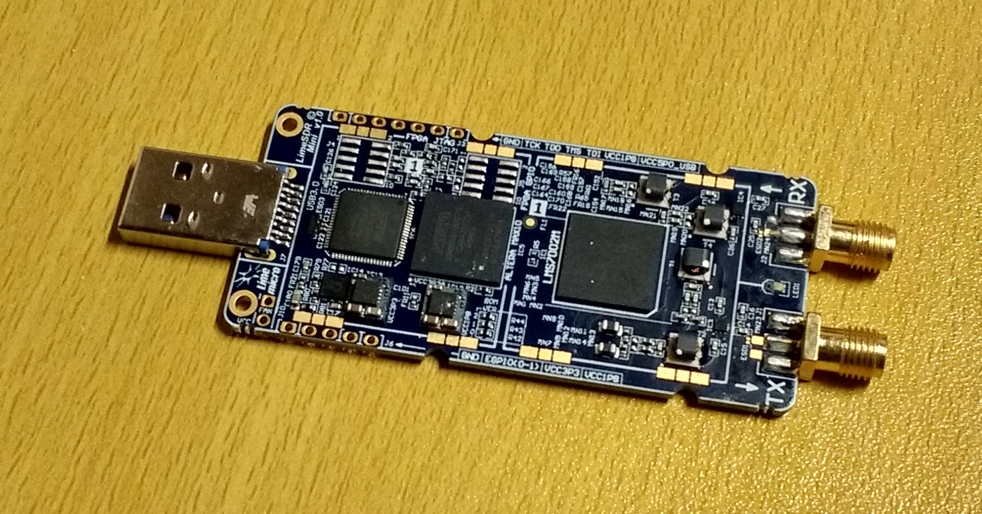

LimeSDR Mini is here!
Just got my hands on it today :grin:

Broken??
Also dots over Altera look like debris…
No panic, please, it is not :slight_smile:
It is just poor picture quality. This is a small PCB:
No panic, Alexandru might simply have received a defective one. Or damaged on delivery. Picture is quite misleaving.

Yes, no panic, the unit is recognized just fine both by LimeUtil and SoapySDRUtil:
SoapySDRUtil --find
## Soapy SDR -- the SDR abstraction library
Found device 0
  addr = 24607:1027
  driver = lime
  label = LimeSDR Mini [USB 3.0] 1D3548C4603D34
  media = USB 3.0
  module = uLimeSDR
  name = LimeSDR Mini
  serial = 1D3548C4603D34
Picture was taken with camera in my cheap phone under poor light.
