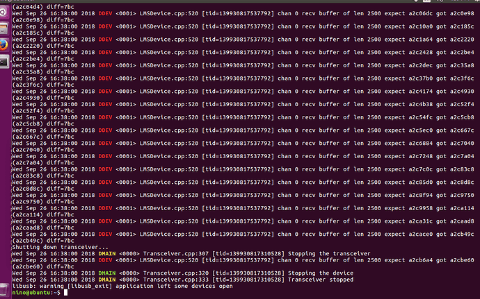

Why do I still have this error with osmo-trx for openbts?
I tried with and without uhd, with and without soapyuhd, with osmo-trx-limesdr.cfg -f and default.cfg -f … I always have these errors.
I tried in usb 2.0 and usb 3.0 … I still have these errors.
It seems a bit more stable with an installation with uhd and running osmo-trx-lms -C default.cfg -f
But still these insuoportable errors.
Do you know what to do to stabilize the operation and not have these errors?
              Can this help someone to help me
[FATAL] [UHDSoapyDevice] Rx Calibration: Bandwidth out of range, available range: from 2.5 to 120 MHz
