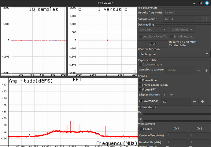

Now i’m not sure what to do. I don’t have a clue how to use LimeSuiteGUI. I don’t know what most of the buttons mean, although I found out SXR is for receive so I tried to receive a local FM station and view the FFTviewer. I would greatly appreciate any links describing how to use the software, although I read in a post that it is highly technical and generally recommended to use another sdr software. This is what it looks like. I think it’s just noise and not working, but maybe i’m missing something.
