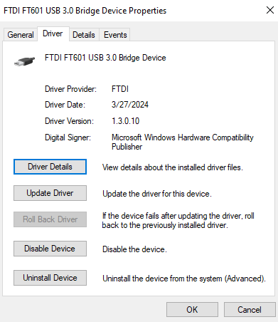

I have a LimeSDR Mini 2.0 device that is recognized by Windows as “LimeSDR Mini (Interface 0)” in Device Manager.
I successfully installed the WinUSB driver using Zadig, and the LimeUtil and LimeSuiteGUI tools are installed correctly.
However, when I run:
cmd
LimeUtil --find
it returns no devices found.
I also attempted to flash the FPGA using LimeSuiteGUI → Modules → Programming, with the correct.bitfile (LimeSDR-Mini_HW_2.0_r2.2.bit), but I receive a “Programming failed” error every time.
The LED on the board is constantly blinking and never stabilizes.
I believe the device may have a hardware issue (FPGA or flash failure).
Could you please assist or advise on how to proceed?
The LimeSDR Mini 2.0 is visible in Device Manager, and I have installed the WinUSB driver using Zadig. However, the device does not appear in LimeSuiteGUI, and LimeUtil --find returns no devices. The LED keeps blinking and the FPGA cannot be programmed — I get a “Programming failed” error every time.
