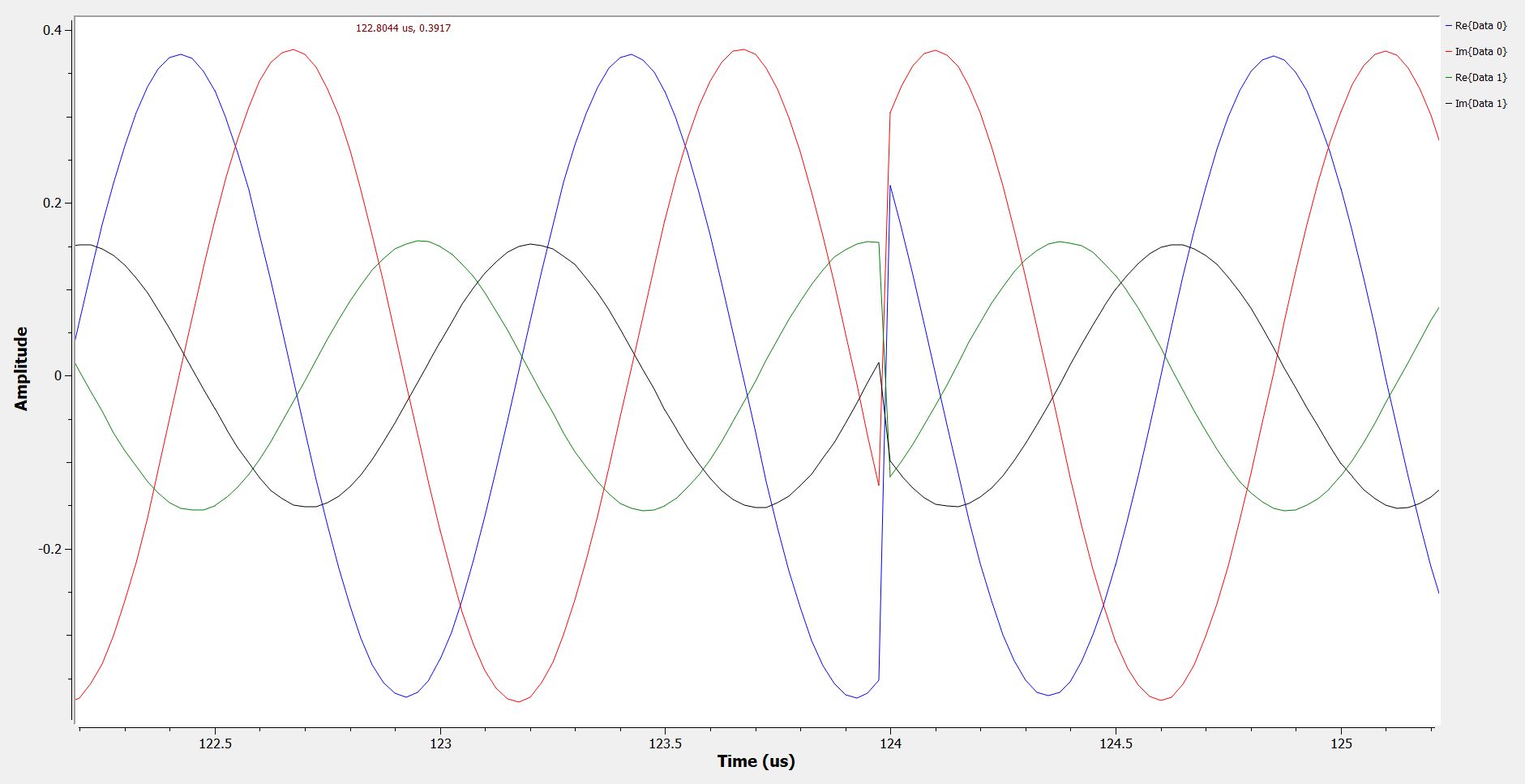

I’m using a LimeSDR usb as a RF reciever with GNU radio and have noticed that at high sample rates (40 MHz) that there is a drop out in the IQ series. It seems constistantly spaced at ~12 us and occurs in both reciver channels at the same time so I was thinking it was some sort of buffer issue? Has anyone come across this before and would anyone be able to help? Any advice is welcome, pictures included below:

This is zooming in on one of those lines, where the data is dropping. You can see both channels drop synchronously.
