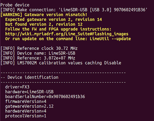

LimeSDR was running fine when I installed limesuite and soapy packages according to the installation guide on the myriad forum but I needed to install some additional modules for the gnuradio so I installed with pybombs. Before the pybombs installed on the grc terminal limesdr was automatically loopback calibrated. After the pybombs There was an error as “LMS7002M calibration values catching disable” What can be wrong? You can check via photos with/without pybombs. And also GRC with pybombs cannot be closed in a normal way. Thanks for any help

Thank you Andrew there is also another thing. Even I updated gateware version by LimeUtil --update, gnuradio terminal says gateware version mismatch. Sometimes it doesnt say which is very wierd. It occured after I cleared all drivers, gnuradio, etc and reinstalled them. And also there were no [INFO] Reference: 3.072e7 MHz line before.
If you ever see “found version 0, revision 0” this is likely to due power supply / cable problems. If it seems that some applications expect a different version, where others do not, it is probably that you have more than 1 copy of Lime Suite installed — e.g. on different O/S or from source and package on one — and they are using different libraries.

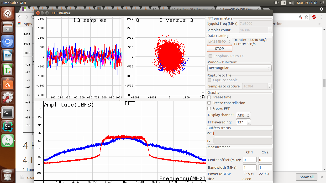

Hi Andrew I am having serious problems with my limeSDR usb version Currently I cant open self_test.ini file on limeSuiteGUI. even I tried to reset I received errors and there is a failure with loopback I also have problems working on gnuradio How can I reset everything on the board? Is it related with soapy drivers? I can see SoapySDRUtil --find without any issue.
