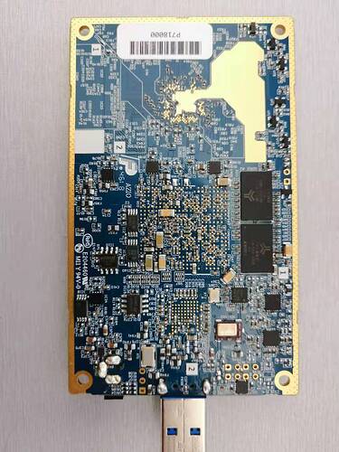

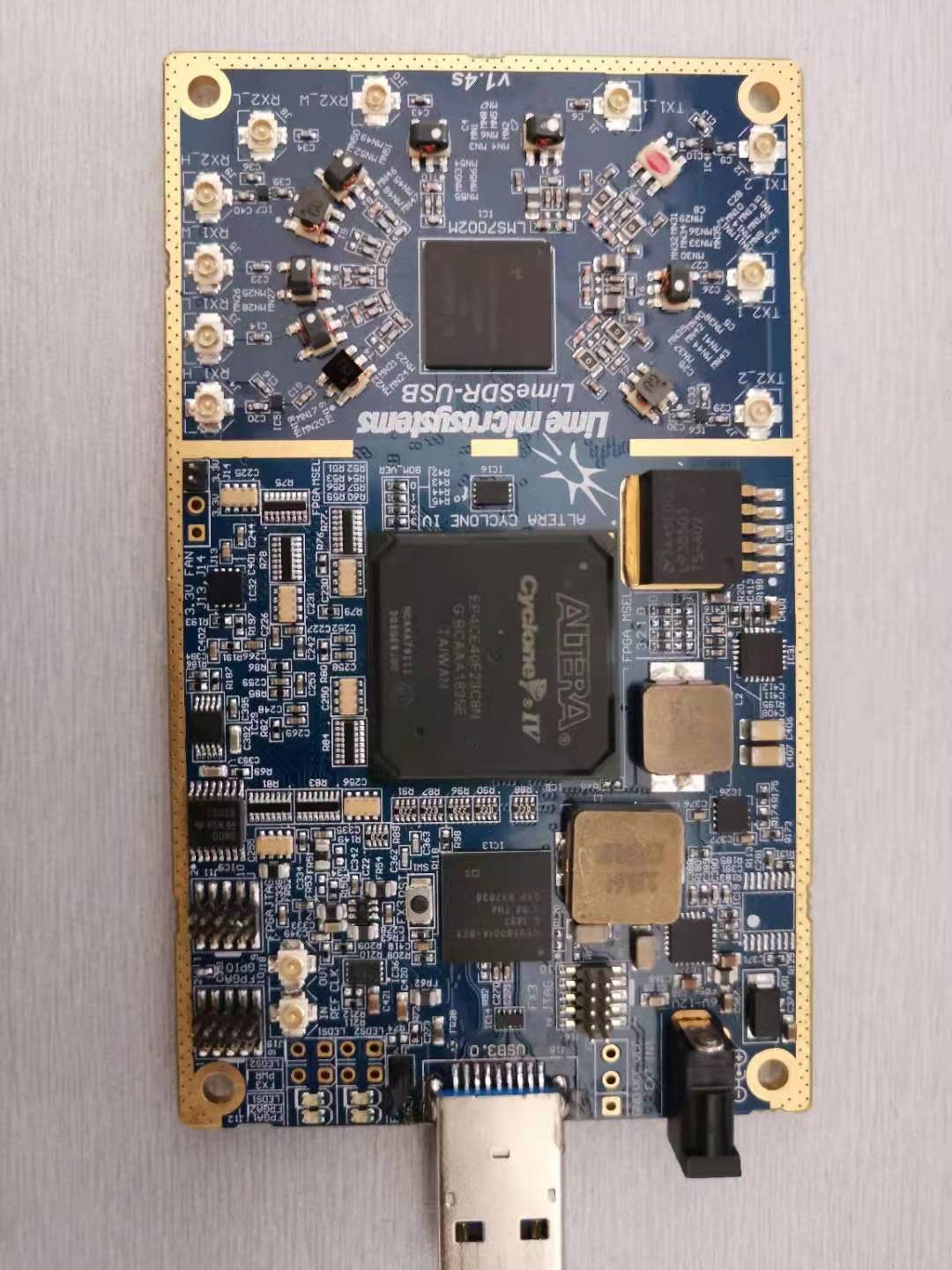

After my LimeSDR(v1.4s) is plugged into the USB3.0, LEDs1 is always red:
I didn’t have External 6V - 12V power source, just USB3.0.

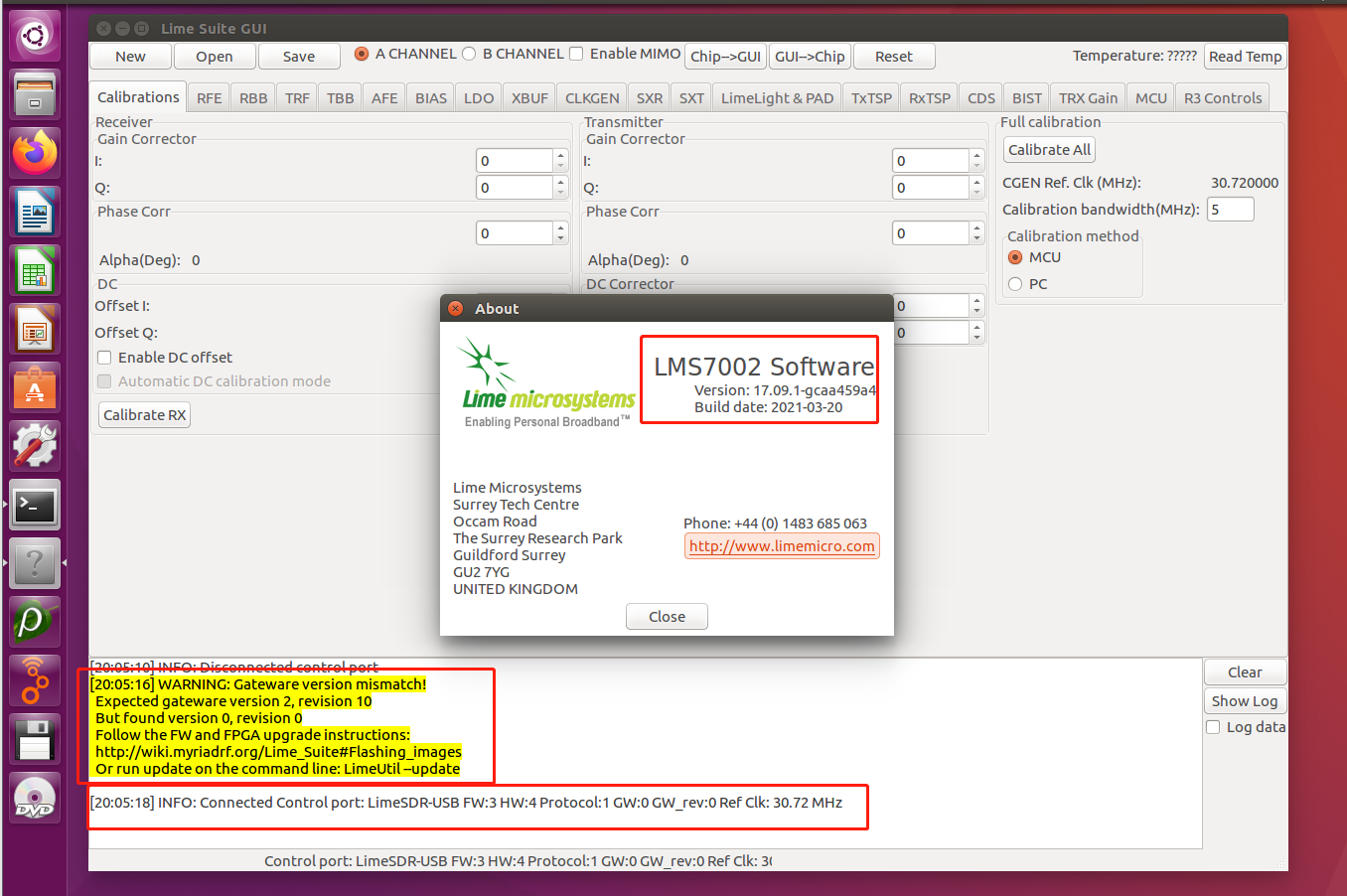

My LimeSDR has “gateware version mismatch” error and I can’t solve it with the “LimeUtil --update” instruction(It executed normally but it didn’t work…):
Here is the LimeSUiteGUI’s info,GW is not right. I have tried the latest version of LimeSuiteGUI and Modules-Programming, it executed normally but it didn’t work, so I used the old version:
The result is still the same.

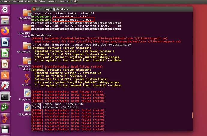

When I try the --probe option with SoapySDRUtil I got the errors:
