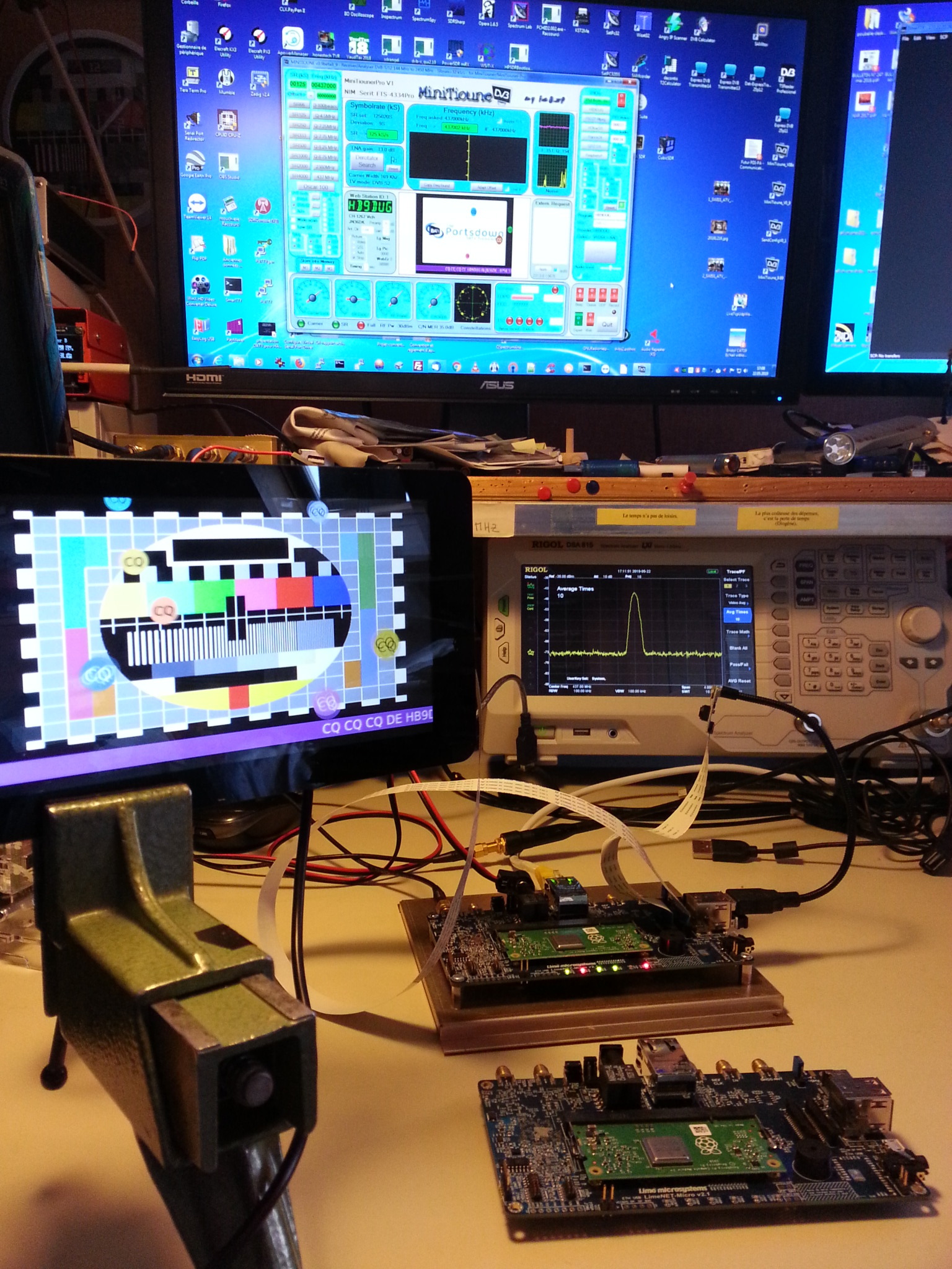

I have two LimeNet Micro. One is working nicely (see
[https://twitter.com/swissatv]) so it is not related to a wrong hook up of the cables and jumpers as the second one is configured exactly as the working one. Of course, I have already try to remove the RPI CM3 module without success.
I should say that the defective one has been working correctly. It is only after a few switch on over 2 - 3 days that it didn’t boot up with no LEDs on.
Cordialement,
Michel
