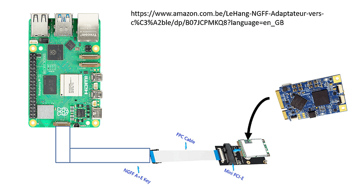

Just to weigh in with my findings on converting Raspberry port to mPCIe, I do not known about the srsRAN side of things. I tried a few options, and in my opinion this is the best way to interface an XTRX to a standalone Pi on x1 PCIe:
(proven with two samples)
