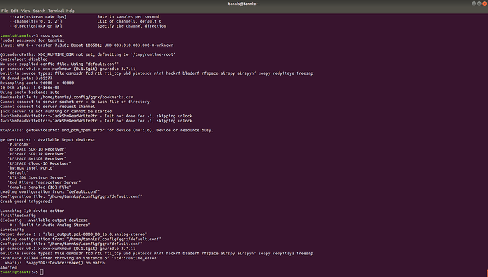

I have installed the Limesuite, and I am able to connect to the board and calibrate it. I can run SoapySDRUtil --probe and can see my device.
When I try to run GNU Radio and GQRX, I get the same issue in the console. I have tried installation setup and setting for both programs that I could find on this forum and nothing has worked.
GNU Radio
GQRX:
Both cases have a “SoapySDR::Device::make() no match” error and I can’t find anything on this forum or on Google.
Help please? I got the LimeSDR Mini for Christmas and it has been a huge headache trying to get this running.
