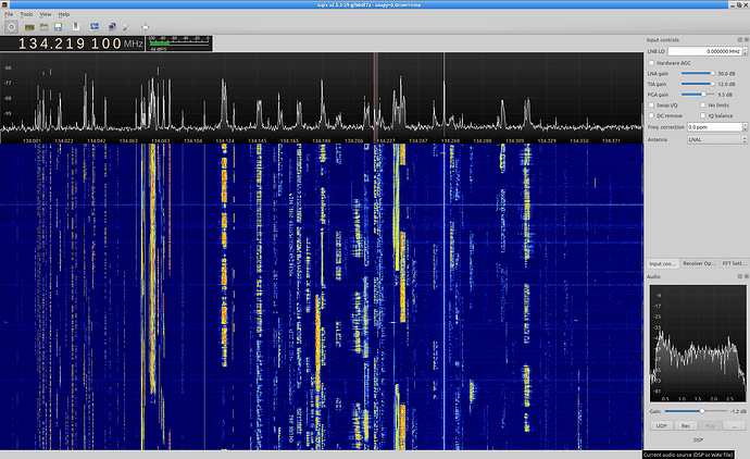

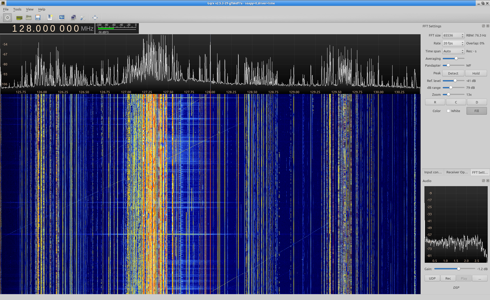

I did this back in May using my v1.2 board and here are some screenshots in case you are interested ![]()
- Location: Denmark
- Antenna: HyGain DX-88 vertical
- Converter: Spyverter, 120 MHz LO, powered through USB
Thanks @csete, I had forgotten about those!
I’m still hoping to see a comparison of external upconversion versus internal upconversion in the lowest range specified for the LimeSDR (100 KHz to at least 500 KHz). I would expect the external upconversion to be much better. It would be interesting to know at what frequency the internal upconversion equals the external one (SNR-wise).
Chuck,
I don’t think I have posted these screenshot before, but I may be remembering wrong. My LimeSDR is quite deaf on LW and MW with the simple modif I made but I do not have a proper antenna for these bands. So, lets hope somebody else can make that comparison.
