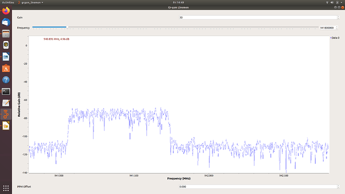

The problem now is that although the program runs (grgsm_livemon) theres no output on the console like on grgsm with an rtl and also a big center spike in the signal no matter what freq i tune to. (picture below). The changes I’ve made to grgsm_livemon.grc
1 replace the rtl block with limesdr one
2 changed both gain variable and slider to int as float was causing problems.

I’m assuming that its a product of the IQ samples and that there is no correction in the Lime source block as there is in the RTL and osmo ones.
