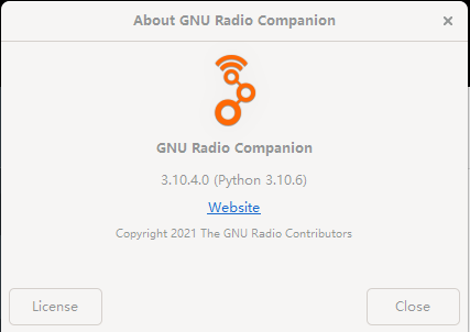

  1. my GNU Radio Companion’s version is 3.10.4.0, is that too high

hi, I have resolved this problem, which is due to edition.
After I changed to GNU Radio3.7, it success.
