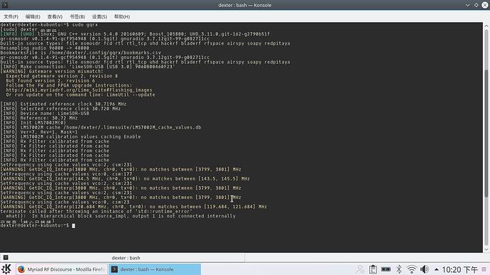

GQRX crashed when running with LimeSDR
my OS is kubuntu16.04, and I have installed driver.
here is the message from Konsole:
Could anyone help me please?

Try updating your board with LimeSuiteUTIL first …

It’s repeatable. No matter using win10 or kubuntu16.04.
and I have already update the board.
and its the same computer running Win10 and Kubuntu16 ?
yes, the same computer
