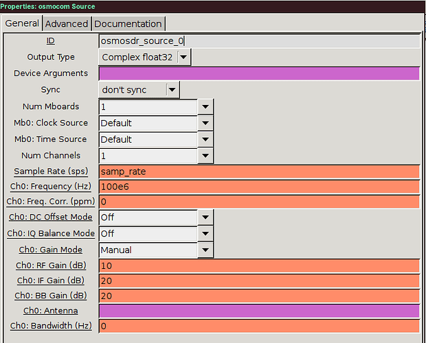

one problem I’m having is that because there are so many abstraction layers between gnuradio and the lms driver, it’s very hard to adjust parameters on the lime that aren’t thought of ahead of time.
so when we are using a source block for the lime using gr-osmosdr we see the below dialog,
but there is no way to set the TIA Gain.
I think gr-osmosdr (through soapy) technically supports setting any gain, but it’s just not surfaced in the dialog… I’ll have to experiment with modifying the dialog.
So it’s probably possible to modify the python file that gnuradio generates to set the approriate gains/settings.
Of course, it’s isn’t ideal when prototyping, because re-generating the flowgraph then wipes out your modifications.
