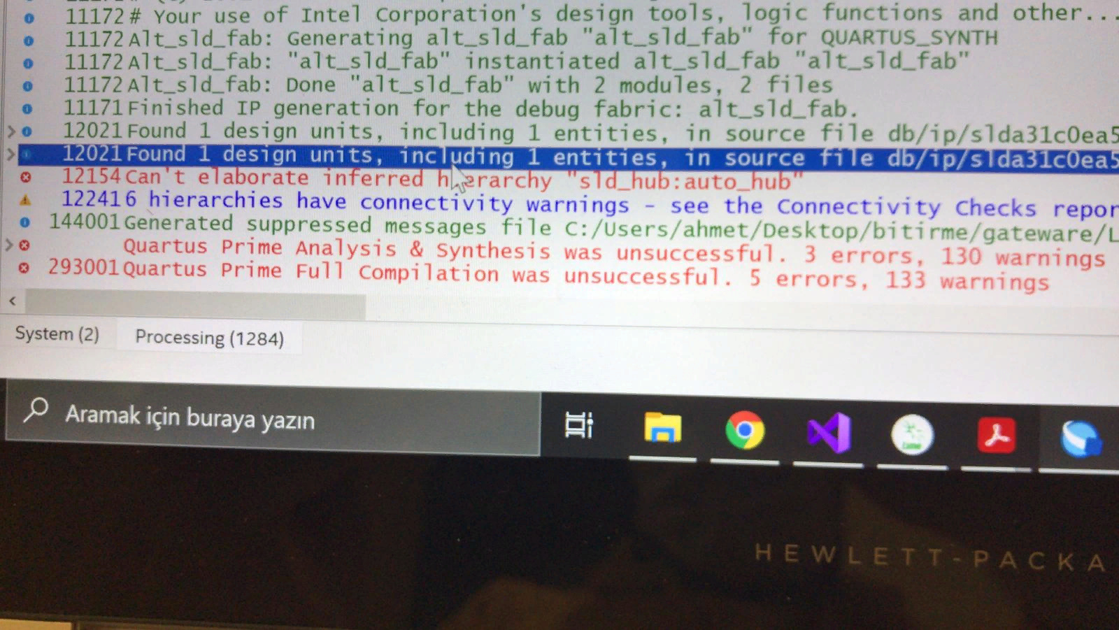

I recently downloaded the quartus software and also the vhdl modules given in the official github. However, the code does not compile. Am I doing something wrong?
Are you using the exact same version (Altera Quartus prime 15.1 Lite Edition with Cyclone IV device support) that was used for the gateware development ?
If you search, you’ll find that other people had similar problems attempting to use later versions.
