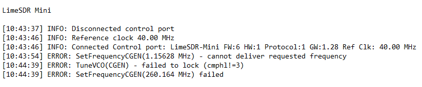

Trying to install two old LimeSDR - one mini, one full USB - neither work properly. Tested with powered USB 3 hub as well.
Details:
https://twitter.com/gm8arv/status/1088028258518687744
https://twitter.com/gm8arv/status/1088028574743810048
Have I missed something obvious?

For the LimeSDR-USB and the LimeSuite I see:
[13:09:08] INFO: Disconnected control port
[13:09:40] ERROR: Write(64 bytes) failed
[13:09:40] WARNING: Gateware version mismatch!
Expected gateware version 2, revision 19
But found version 0, revision 0
Follow the FW and FPGA upgrade instructions:
http://wiki.myriadrf.org/Lime_Suite#Flashing_images
Or run update on the command line: LimeUtil --update

Just tested on a third PC with the same result. Noted that I could use LimeUtils --update to write 1.27, then use LimeSuite, Programming which gave me 1.28. Running LimeUtils again said 1.28 > 1.27 and refused to write the older firmware, so that behaved as expected. I could then run LimeUtils --update --force to write 1.27, which worked as expected, so there is some communication between PC and the Lime Mini.
