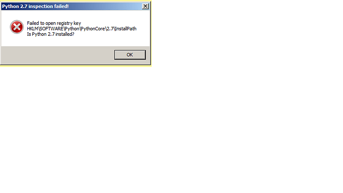

Error: Python 2.7 Inspection Failed
When I try to open GNU radio companion it says “Failed to open registry key” …has a registry path that ends with “Is python 2.7 installed?”
This is on a new install of windows 7. I downloaded and reinstalled python, then uninstalled and reinstalled it a couple of times. Same thing.
Any ideas?
Thanks
Hello @fltech,
I had the same issue on a windows 10 machine and was about to give up on trying to get it working, but one last ditch try seemed to work.
I started off by uninstalling anything related to Python, GNU radio and PothosSDR, I then deleted any directories that had been left behind, especially the python directory that may have been installed inside the program files directory, but also any that had been installed in the root directory.
I then choose to follow the instructions on this page:
and specifically this
  1. Install Python2.7 for amd64
This is a 64-bit installer and GNU Radio requires the 64-bit version of Python 2.7. Look for the “Windows x86-64 MSI installer” on the python downloads page.
Note: If you choose to customize the python install options, make sure that the “register extension” box is checked. This tells the installer how to find Python at runtime through the windows registry.
I don’t have that PC in front of me at the moment, but from memory the new install defaulted to the root directory.
After following the instructions on the above page and the linked pages of installing PothosSDR I eventually got to a point where I could get GNURadio running on my machine.
