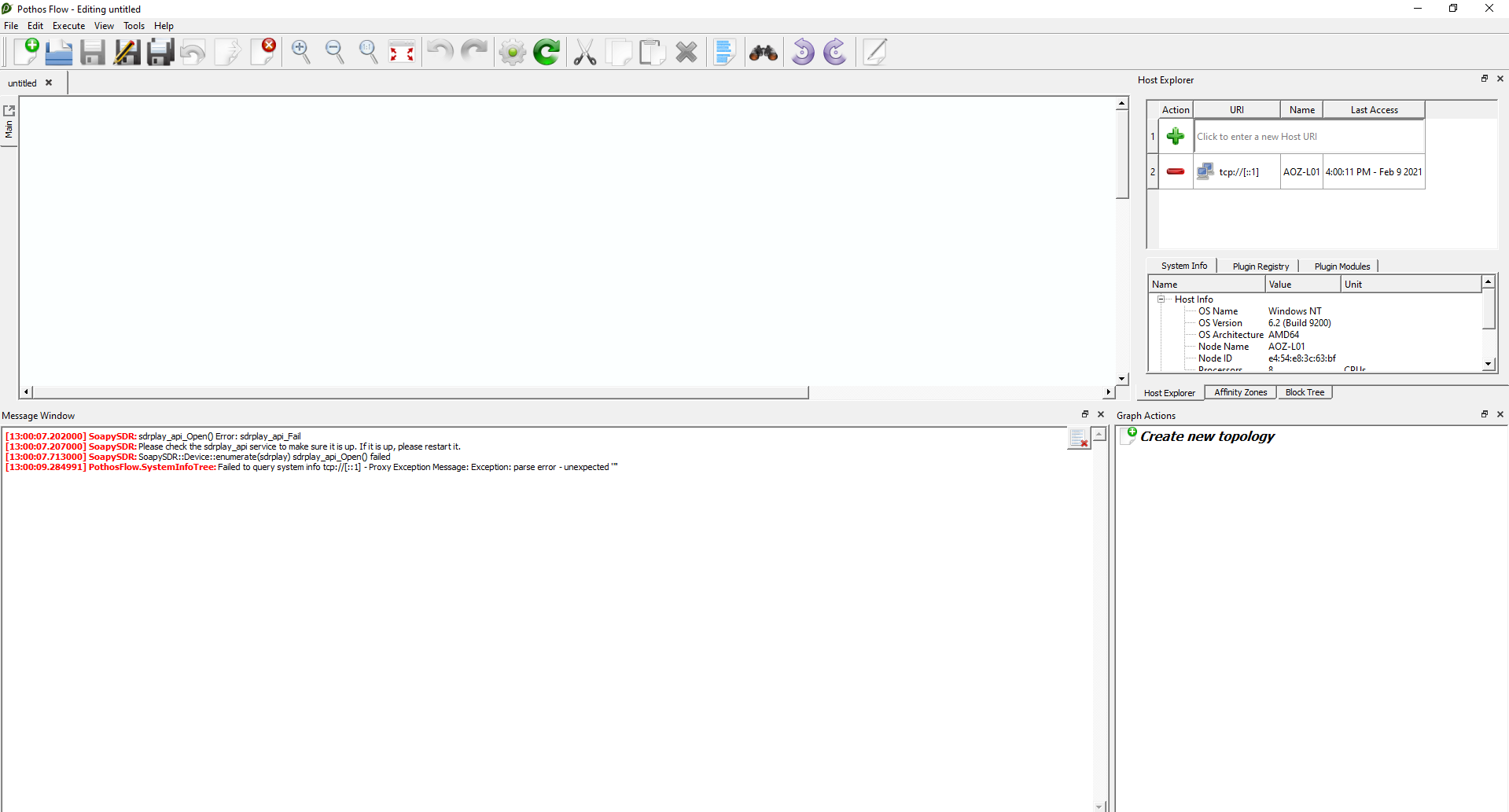

i have cs-lime-01, i have installed driver and i can connect with lime suite gui. But i could not to the pothos flow added ss to the attachment. How can i connect limesdr to the pothos flow

Looking at the error message in red text above, it looks like soapy scanned for and found the first SDR hardware in your computer for which it has a module installed, which I am guessing is probably missing some wrapper for access to the SDRplay API (I do not know for sure because I do not own that hardware, but that would be my guess).
