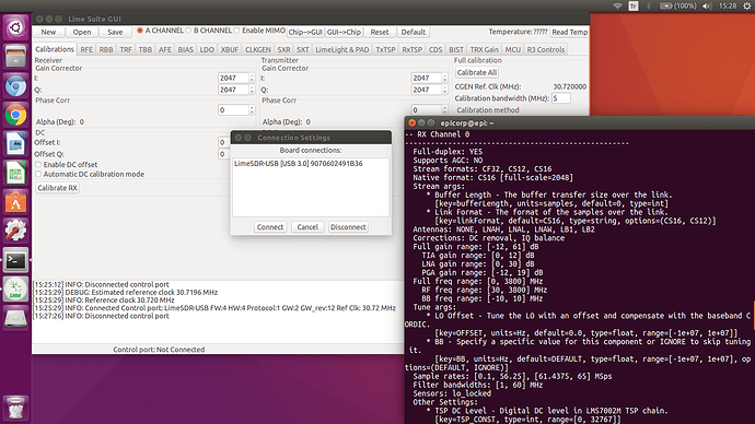

I tried with different samp rates starting from 50 to 60mhz. the program was ok at 56mhz but gave an error at 58mhz. Is it because of the internal filters in the limesdr? I still have 4mhz bandwidth loss Here is the photo
Still couldnt manage to get 60mhz and also bandwidth on the osmocom fft viewer cant exceed 40mhz but on gnuradio I can see max 56mhz
