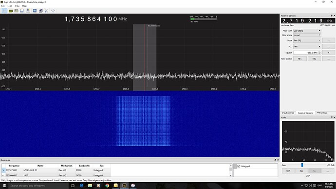

It seems like my phone is actually using band 3: (1710 - 1785 and 1805 - 1880)
This is not what I was expecting - the data seems to be in a band 0.2MHz wide comprising of about 30 different signals. It’s also intermittent, which makes sense and always comes on when I press the ‘check email’ button on my pc (The phone is my modem).
I just hope I’m not picking up some kind of signal from the PC itself?
If anybody could confirm that this is a 4g cell phone Rx signal, then that would be really great!

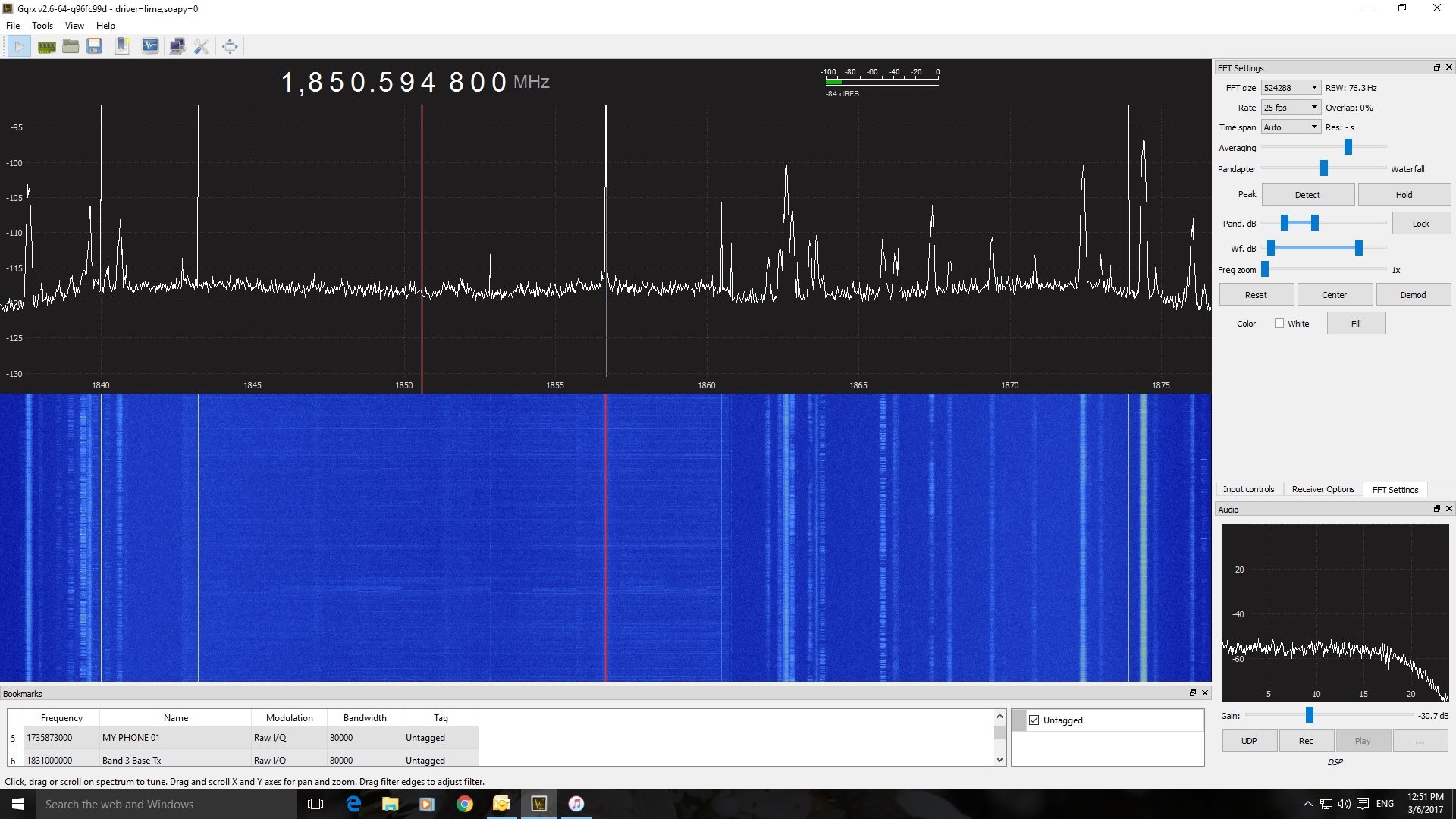

In the meantime, here’s the Base station Tx’s:
Obviously, I wouldn’t be posting this message if I really knew what I was doing so any help is appreciated! It seems like some base tx’s have a stronger signal than others and I don’t know if this is normal - I’m guessing the base station can recognise a phone struggling to connect in an area of poor reception and so gives out a few more decibels to compensate?
