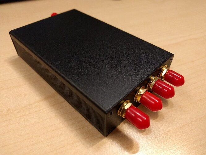

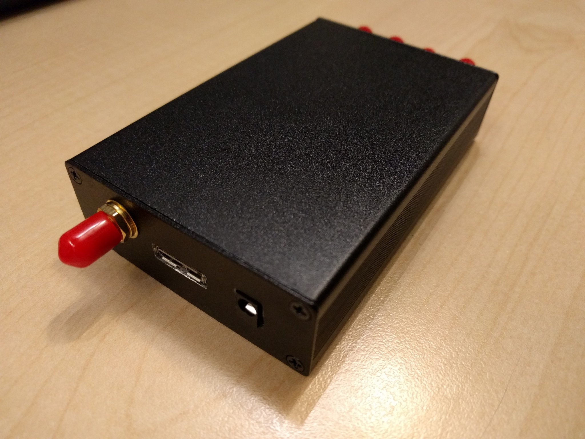

Just drilled and filed the holes for the connectors and assembled my aluminium case. I have to pay attention to the temperature though, I think I will add a small fan.
It looks very neat.
I left the bottom 5 holes free to allow some air flow.
I had the lime plugged in for 2 weeks solid and I was happy with the coling.
But that is just me. I want an even temp that does not change too much so as to affect the frequency stability.
Build an internal tower that uses a thermal pad to touch the hot IC’s … the tower bonded to the case. To use the case as a heatsink
