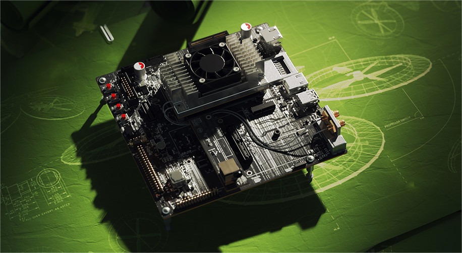

What I find even more exciting is the direction NVIDIA are moving with their Jetson devices.
Where they are combining high speed ARM cores and their GPU technology on the same
piece of silicon sharing the same RAM. This is being driven by Robotics and Self drive vehicles
but is equally suitable for SDR at the ‘edge’. Certainly a technology worth watching.
