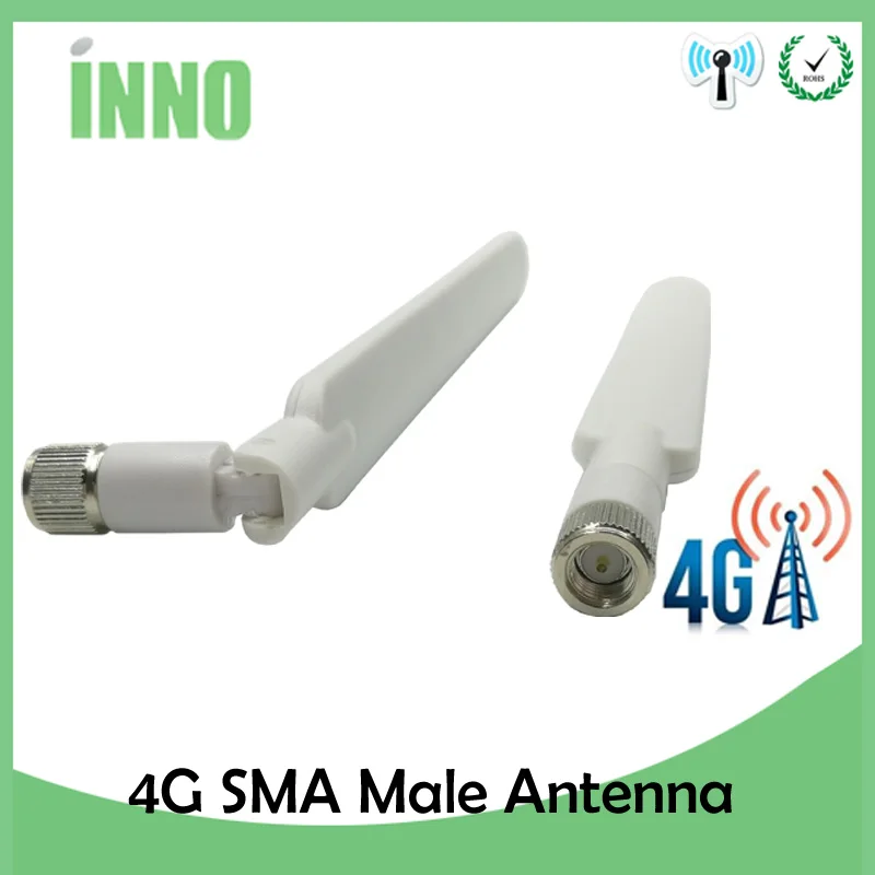

oh no! how would I fix it or trick the cmake to compile ? Would I need to look into something like this https://www.dfrobot.com/product-1727.html
yes, but how cost is it?
Never see this antenna! what is this reference!!! how many dbi is it?
here is a similar antennas on Aliexpress you can check them :
gain = 5 dbi

@dast has your 4G antennas arrived ? did you try it ? is there any thing new ?
ok, i will try it! thankk’s for saying it! did you use ubuntu 16.04 or 17.04?
The high gain antenna is not yet arrived! i use now dlink antenna of lte modem , i could connect it but after some minute it’s disconnet !!! i’m not sure but maybe it’s due to the hot temperature of fpga and lms ci so i do some cooling for it it! it’s not yet finished
