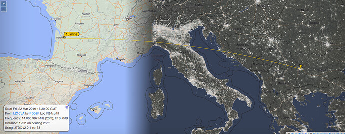

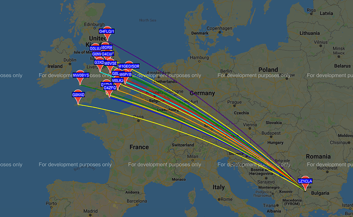

Now it works. Keep in mind that my HF antenna is just a ham stick on my Balcony and it is far from optimal.
