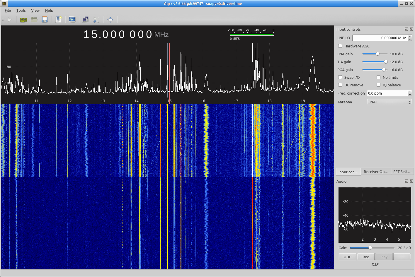

Well, it “works” for me after the mod using gqrx. However, I found that setting the bandwidth to 0 does not seem to select the best bandwidth, at least not from a sensitivity point of view.
The screenshot below shows 10 Msps first using 0 MHz bandwidth then 10 MHz bandwidth.
I only did the super-easy mod by @sdr_research - thanks :slight_smile:

I confirmed this, too, Alex but I had to use a 100 MHz bandwidth because the receive sensitivity was affected by the applied bandwidth for some reason. I tried using 10 MHz and the receive was weak, but when I used 100 MHz and then zoomed in, I had great receive in HF. Not sure if this is an anomaly or not, but it’s not bugging me too much… :slight_smile:

It’s been confirmed that you have to set the Bandwidth on the GQRX application to 100 MHz and the input rate to 10 Mbps…THAT will fix the marginal receive issue. I’m not sure if this is an anomaly or not, but I will defer to @csete to answer that since he’s the author of this GREAT Linux receive app…I used it this morning to confirm the change works on GQRX - try those settings on your side.

Everything looks fine with the settings - I had to change my Bandwidth to 100 MHz to make GQRX happy. Try it at 10 MHz and if you don’t have luck there, then try 100 MHz for the Bandwidth.
